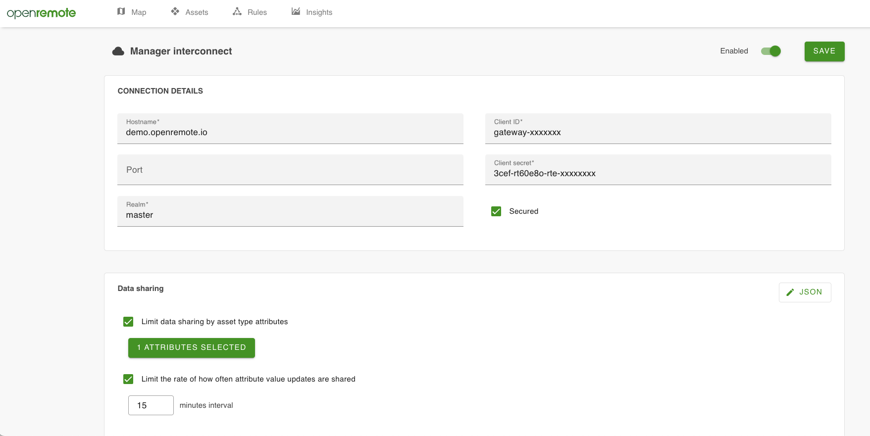

2. Entering credentials in the edge gateway (Connection details)
- On the edge gateway login to the manager UI and select the realm you wish to connect to the central manager (only applicable to superusers).
- Go to the Manager interconnect page (top right menu)
- Enter the host (e.g.
demo.openremote.io) - Enter port if not using default
80or443 - Enter the realm of the gateway asset on the central manager (e.g.
master) - Enter Client Id and Client Secret which can be found by looking at the attributes of the gateway asset in the central manager
- Select secured (if the central manager is using
HTTPS) - Click Save
- In the top right of the dialog the status should change to
CONNECTED

3. Limit data rate at which edge gateway synchronises (Data sharing)
- Select the asset type and attributes which you want to synchronise with the central instance
- Select whether you want to limit the data rate and set the time interval
