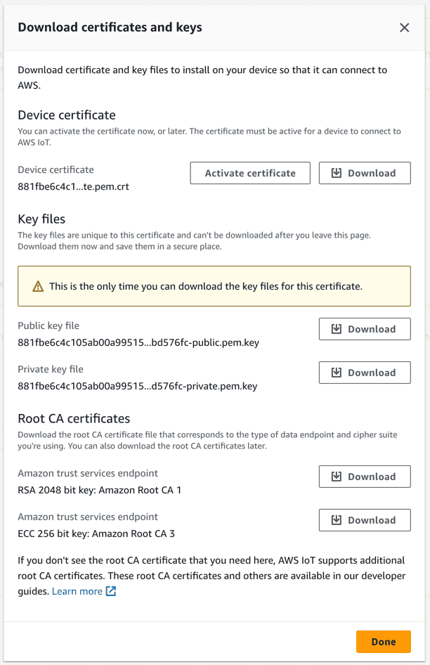

After creating a Thing in AWS IoT Core, you need to retrieve its certificate, its private key, and Amazon's Root CA certificate.
They are all provided after accessing that thing's dashboard and creating a new certificate for it: img.png
Download the Device Certificate and activate it, download the private key file, and the Amazon Trust Services endpoint RSA 2048 bit key.
