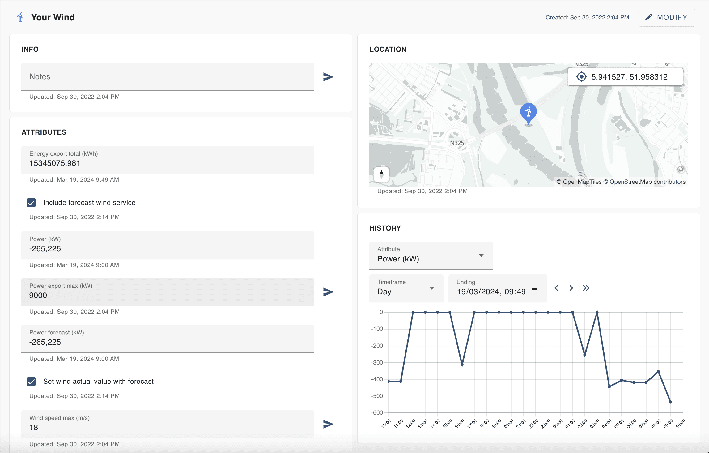

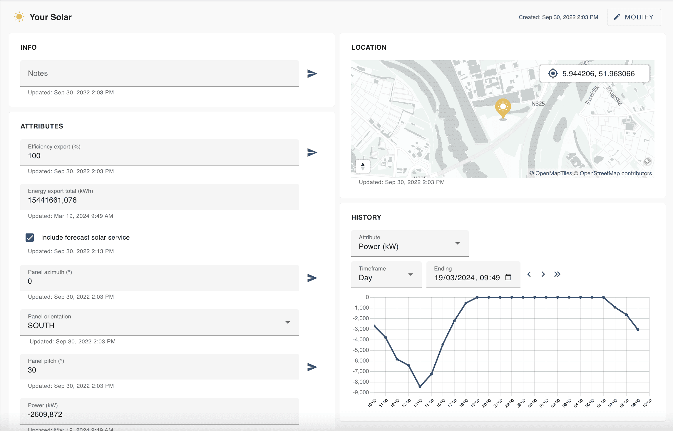

We are first adding the (renewable) energy production, by adding a PV solar Asset (Your solar) and a Wind turbine Asset (Your wind). Both need to be added as children of the Optimisation Asset. These assets include a series of standard attributes as shown in figure 2 and 3.
Solar Asset Figure 2. The PV Solar asset (Your solar) with the respective attributes.
Wind Asset Figure 3. The Wind Turbine Asset (Your wind) with the respective attributes.

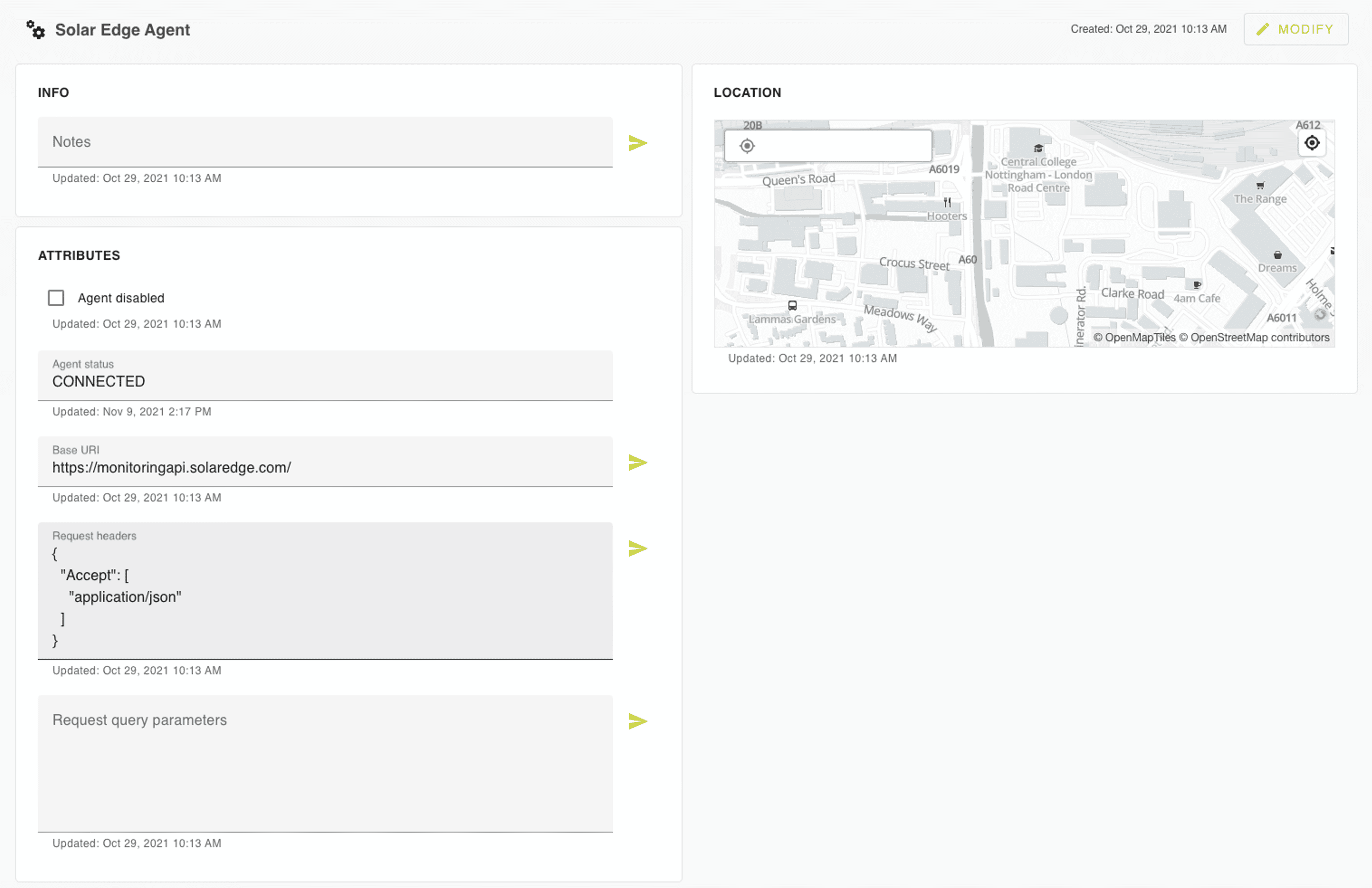

To configure and connect your PV Solar asset to your own solar system you can use the Agents. Most importantly you need to connect the actual power (the attribute called power) and the energy meter value (the attribute called energy export total). In this example we connect a solar system from Solar Edge. First add an HTTP Agent and configure the Base URI and the Request Headers to connect to your Solar Edge system (see figure 4).
SolarEdge HTTP Agent Figure 4. The HTTP Agent, configured to connect to Solar Edge.

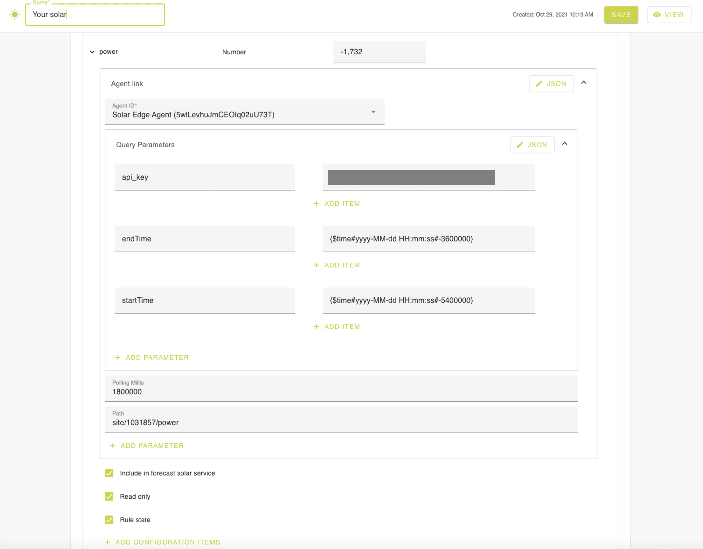

Secondly, select your solar asset, select 'Modify' (on the upper right of the asset page) and connect the power attribute of the PV Solar Asset to this Agent. To do this uncollapse the power attribute, add the configuration item 'agent link', and add the required parameters (see figure 5). Also add the configuration items 'Rule state' (so you can use the attribute in rules) and 'Read only' (so you can't accidentally write a value in the 'VIEW' mode). Note the +/- sign convention, relevant for the optimisation to work: we use + for consumption and - for production. So in this case, as we are looking at power production, the power values should be negative. In a similar manner you can connect the 'Energy export total' attribute to the energy meter value.
Solar Agent link Figure 5. The connection of the power attribute in your solar asset, using 'Agent link'.

You also need the forecasted power for your solar system. Therefore, remember you need to have added the access key for the external 'forecast.solar' service earlier when setting up OpenRemote and customising it. You can register for a public free account to get the API key first.
To be able to forecast the solar power, you have to fill in the following attributes in your solar asset (see also Figure 2):
  • Panel azimuth (South orientation or a perfect East-West orientation for an East-West panel orientation equals 0 degrees)
  • Panel orientation ('SOUTH' means all panels are oriented in the same South direction; 'EAST WEST' means an East-West configuration)
  • Panel pitch (horizontal is 0 degrees)
  • Power export max (the installed peak capacity in kW)
  • Location. You can do this in the 'MODIFY' mode by opening the map modal next to the location attribute and setting the location by long-pressing on the map.
Now you can turn on the attribute 'Include forecast solar service' on your solar asset. Once saved the forecast service is running. To see it in action you can go to the 'Insights' page and select the 'Power' attribute in a chart. The dotted line will represent the forecasted data.
If you also want to store the data for forecasted power to compare it with the actual values, take care you add the configuration items 'Has predicted data points', 'Read only', 'Rule state', and 'Store data points' for the attribute 'Power forecast'.
Another option is to turn on the attribute 'Set actual solar value with forecast'. This is convenient if you can't get live power data for your solar panels. The actual 'Power' will now also be set by the forecast.
Wind Turbine​
Your wind turbine asset is configured in a similar manner. First connect the 'Power' (note the negative value) and 'Energy Total Export' to an Agent which connects to your wind turbine system. See the PV Solar Asset example above, or check the different Agent Protocol options in the documentation.
Forecast service​
Similar as for the Solar asset, you need a forecast for the wind power as well. For the wind power forecast to work you need to have added the access key for the external 'OpenWeather' service earlier when setting up OpenRemote and customising it. You can register for a public free account to get the AppID key.
To be able to forecast the wind power, you have to fill in the following attributes in your wind turbine asset (see also Figure 3):
  • Power export max (also called nominal or rated power in kW at the nominal or rated speed)
  • Wind speed max (also called cut-off speed, the maximum speed at which a turbine is normally operating; above it will be turned down; in m/s)
  • Wind speed min (also called cut-in speed, the minimum speed required to operate the wind turbine; in m/s)
  • Wind speed reference (also called nominal or rated speed; in m/s)
  • Location. You can do this in the 'MODIFY' mode by opening the map modal next to the location attribute and setting the location by double-clicking on the map.
Now you can turn on the attribute 'Include forecast wind service' on your wind turbine asset (see Figure 3). Once saved the forecast service is running. To see it in action you can go to the 'Insights' page and select the power attribute in a chart. The dotted line will represent the forecasted data.
Another option is to turn on the attribute 'Set wind actual value with forecast'. This is convenient if you can't get live power data for your wind turbine. The actual 'Power' will now also be set by the forecast.

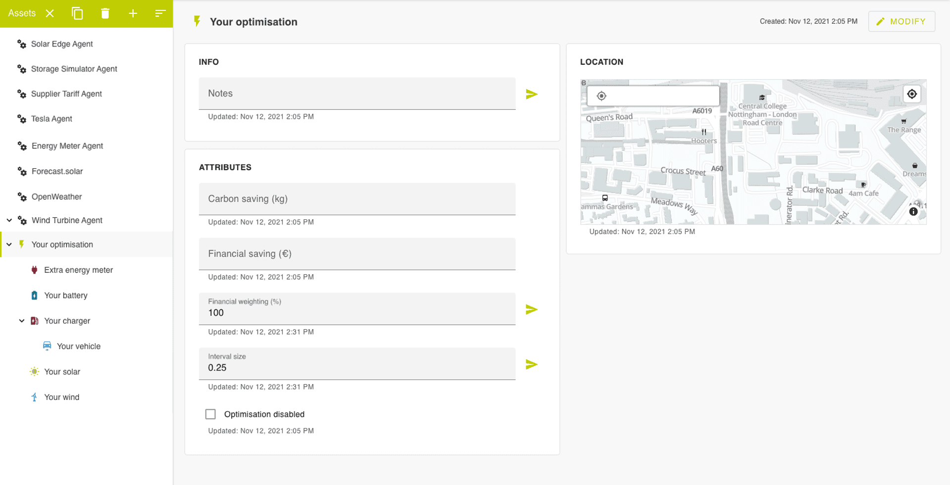

Optimisation​
The asset tree of the EMS you have build should now look like the one in figure 9. The optimisation routine can be configured in the optimisation asset:
  • Financial weighting (between 0 and 100%). This indicates whether you are optimising on costs and or carbon. We have only explained the agile financial cost tariffs for the supplier, so set this value at 100%. In a similar manner, using carbon tariffs (an optional attribute of the Supplier asset) you can optimise on carbon by setting the 'Financial weighting at 0'.
  • Interval size (the interval at which the optimisation runs again, in hours)
  • Optimisation disabled (an on/off). This attribute can only be changed in the 'MODIFY' mode, to (temporarily) disable optimisation.
You have now set everything to run your optimisation. Once optimisation is enabled the optimisation will control and schedule all 'Power setpoints' of assets which have the 'Support import' and/or 'Support export' enabled. It will make the following considerations:
  • Take into account the net resulting power towards the grid (export) or from the grid (import) as the difference between export and import tariffs influence the resulting costs.
  • Take into account the forecasted power, both for electricity consumers and producers, to forecast when there is a net surplus towards the grid or a net shortage of electricity.
  • Take into account the future export tariffs, as it is preferred to charge batteries or vehicles at the time of lowest export tariffs. At that time you would be earning the least by selling, so better store energy.
  • Take into account the future import tariffs, as it is preferred to discharge batteries or vehicles at the time of highest import tariffs. You would pay the highest tariffs if you buy electricity, so better use your stored energy.
  • Take the Energy level schedule of your vehicle into consideration as well as their Energy level percentage min, and always take care that the energy levels are met in time.
  • Prioritise the different batteries, in this case your static battery and your vehicle, based on the so called Levelised cost of Storage (LCOS). LCOS is the additional costs of charging or discharging a battery. It reflects the costs of your battery divided by the capacity times the maximum number of charging cycles, so representing an amortisation. This can be implemented by adding the optional attributes 'Tariff import' and 'Tariff export' to your Electric vehicle asset and your Battery. Note that you should keep the 'Tariff import' value for your vehicle at '0' as charging your vehicle is anyhow required to be able to drive, and the optimisation will not introduce extra charge cycles. We haven't included this in our tutorial and recommend to read-up expert articles before applying.
EMS asset tree
Figure 9. The asset tree of your EMS on the left, with the Optimisation asset selected. Note that the Electricity Supplier is not shown but also needs to be added (for adding the dynamic tariffs)
