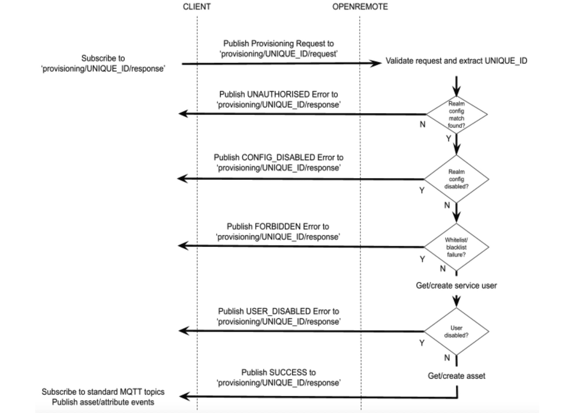

Connect flow​
The following illustrates the connect process (through MQTT topics) which clients can use to auto provision a service user and optionally an asset whose ID is generated using a UNIQUE_ID provided by the client; the client is then authenticated and the asset is then returned to the client.
Auto provisioning Connect flow
NOTE THAT THE 'WHITELIST/BLACKLIST FAILURE', IS NOT YET IMPLEMENTED. THIS FUNCTION ENHANCES SECURITY AS ONLY SPECIFIED DEVICES CAN CONNECT (WHITELIST) OR CAN BE EXCLUDED (BLACKLIST)

Error Type​
  • MESSAGE_INVALID - Failed to parse the request message
  • CERTIFICATE_INVALID - The X.509 certificate is not valid
  • UNAUTHORIZED - No matching config found
  • FORBIDDEN - Unique ID fails whitelist/blacklist
  • UNIQUE_ID_MISMATCH - Unique ID used in subscription does not match credentials
  • CONFIG_DISABLED - Matched realm config is marked as disabled
  • USER_DISABLED - Service user previously provisioned has been disabled
  • SERVER_ERROR - Unknown exception occurred during processing
  • ASSET_ERROR - Asset previously provisioned is not in the same realm as the matched realm config
