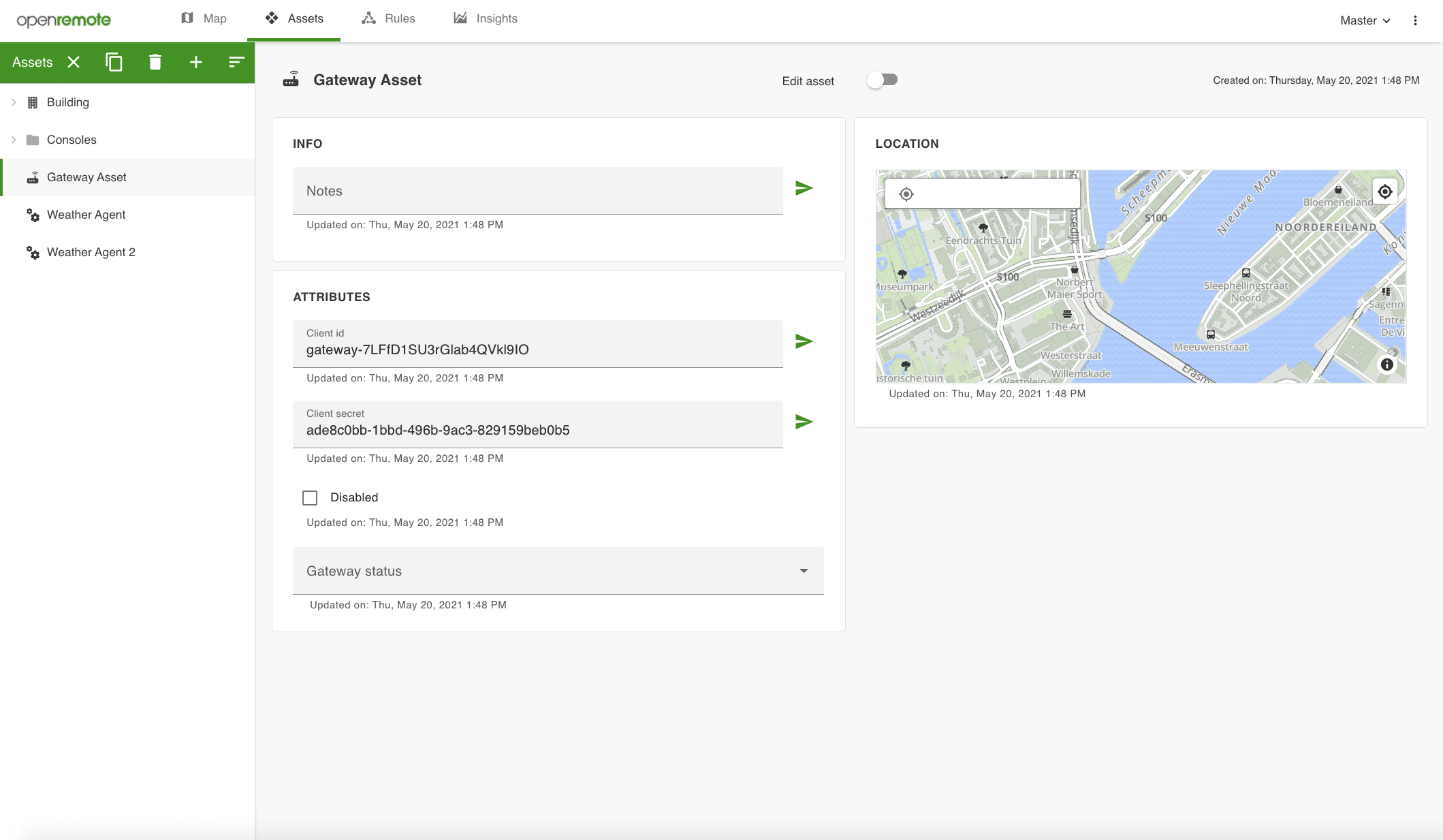

1. Provisioning in the central manager​
Just create a new Asset of type Gateway and the manager will provision a Keycloak client for it with Client Credentials grant type, the client ID and client Secret will then be stored in the clientId and clientSecret attributes of the gateway asset.
