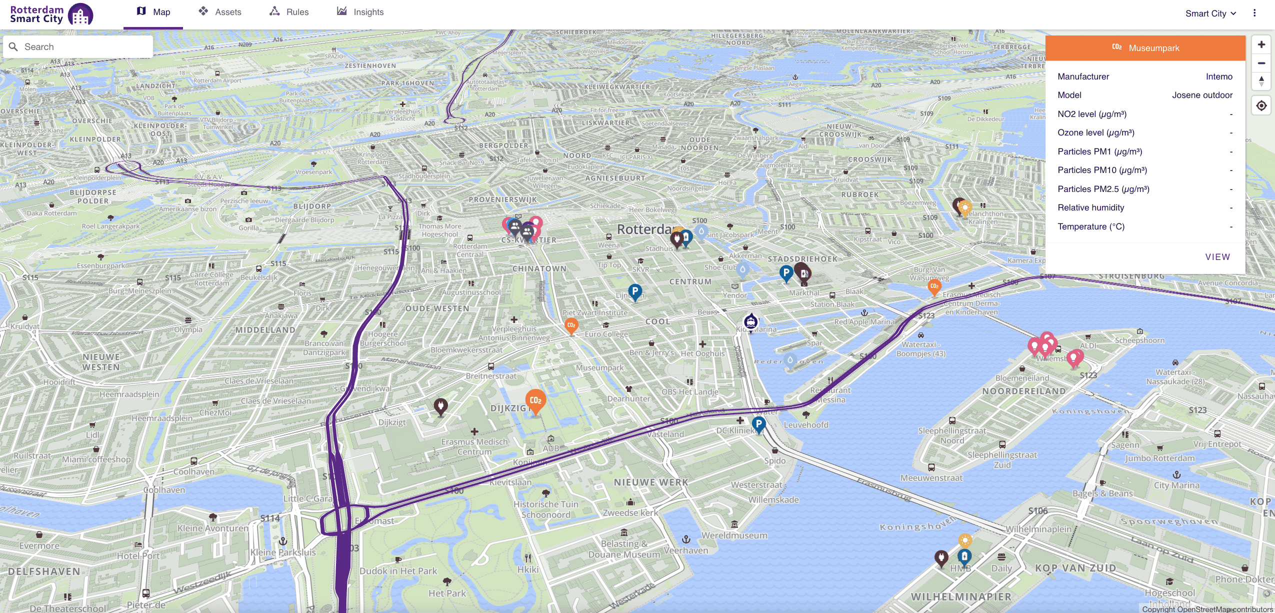

The Map page will show your map. You can pan, zoom, and tilt the map. On the map all assets are shown which have a location (disable it by setting the configuration item show on dashboard to false). Assets can have static or dynamic locations (e.g. a car, boat or plane). You will see the direction an asset is facing or moving to if the asset includes an attribute called 'direction'. When selecting an asset, a panel will show its attributes and values. The Asset details button in this panel will bring you to the respective Asset page.
As part of the configuring the manager UI you can also configure assets to change their colour based on an attribute value (number, boolean, or string) and show a label with or without units.
OpenRemote Map Figure 1. The Map view, here with the Demo Smart City, showing the map with different assets across the city as well as an additional map layer showing primary and secondary highways (GeoJSON). The ship is also showing its direction

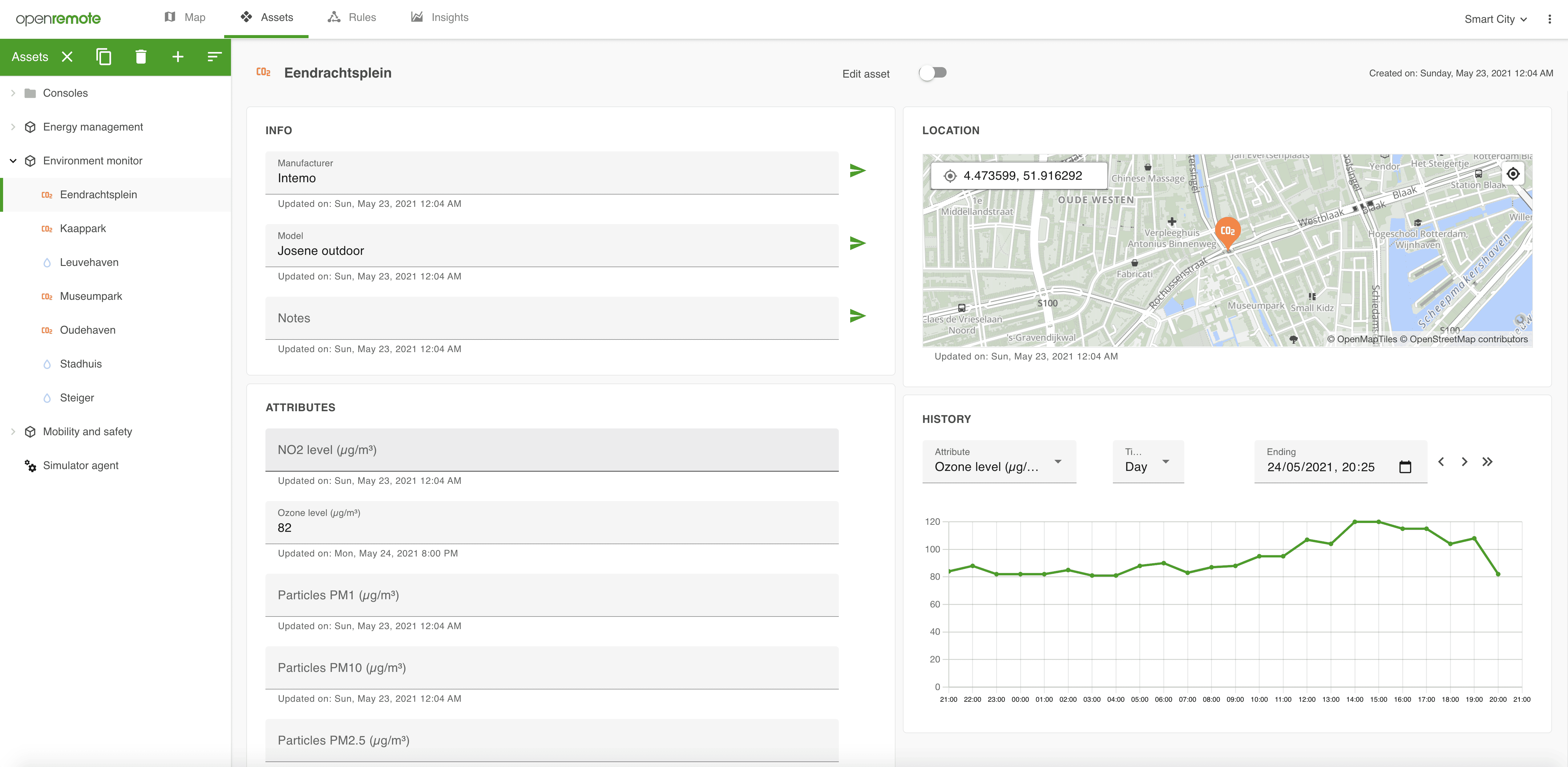

The Assets page lets you view and modify assets and their attributes. You will see the asset tree structure on the left, and the details of the selected asset on the right. The asset page contains an Info panel, an Attributes panel, a Location panel (if any) and a History panel.
The Info and Attribute panels will give an overview of all attributes and their value. These can hold meta-, sensor-, or control-data. For attributes of which the value can be changed via the UI, and for which you have the 'write' role as a user, you can type a value and press 'enter' or press the send arrow on the right (e.g. in below example the 'Manufacturer', 'Model' and 'Notes' attributes are manual inputs). Other attribute values could be live readings from sensors or are automatically updated by Rules.
Figure 2. An asset of the type 'environment'

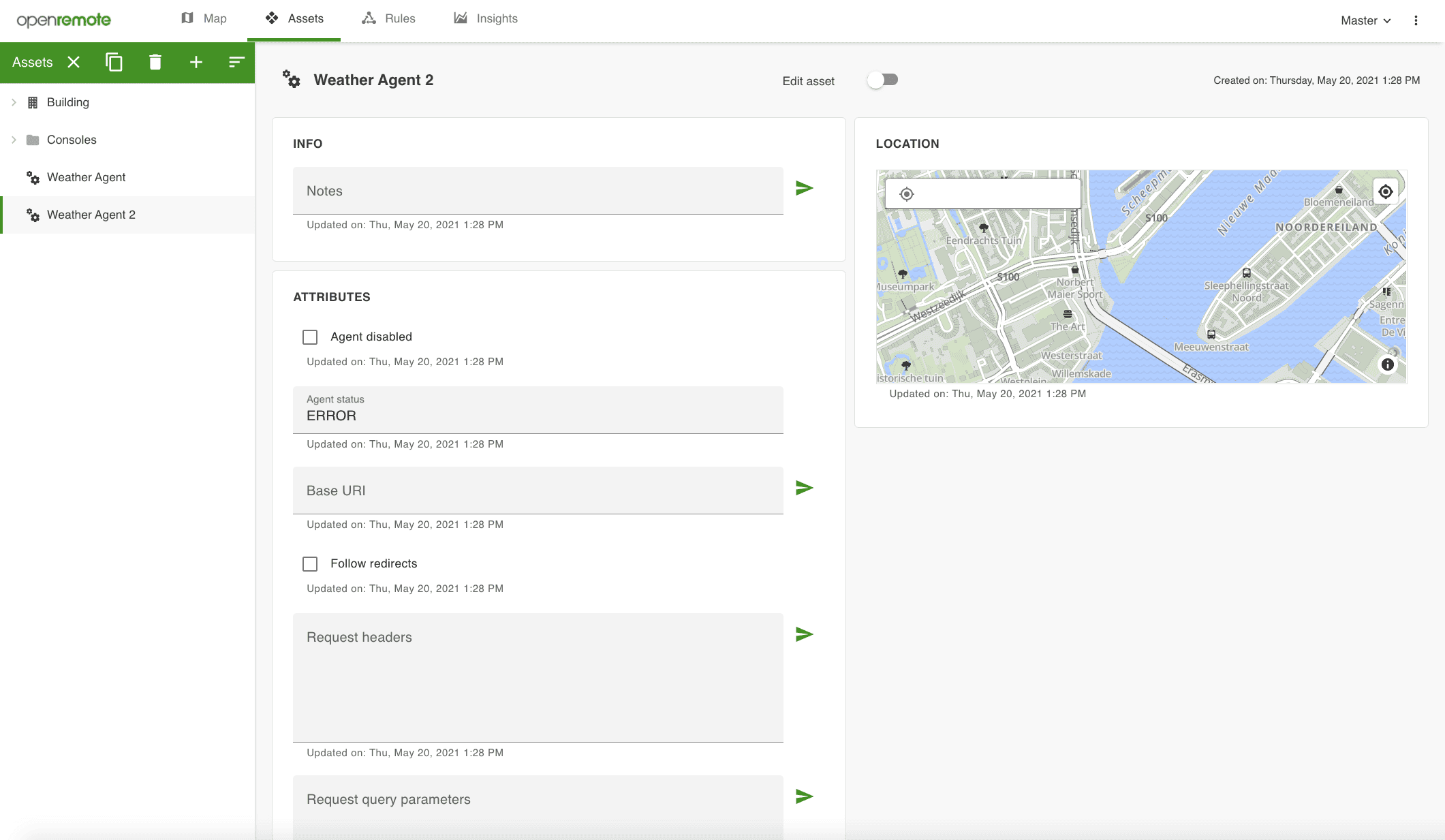

Agents are a specific type of asset used to connect to external sensors, actuators, gateways, or services using protocols. They are added in the same manner as assets by clicking the + in the header of the asset tree. This will open a modal that shows the available agent types at the top of the list. You will see the generic ones: HTTP, WebSocket, MQTT, TCP, UDP and SNMP; as well as more specific ones like Z-Wave, KNX or Velbus. Once you create an Agent, the agent page will display the relevant attributes, required to establish an actual connection to the external world.
Some Agents have auto discovery (e.g. Z-Wave) or use configuration files (e.g. KNX and Velbus). The Agent page will show a discovery button or a file selector. Once set correctly, the Agent will also create an additional asset/attribute structure for all discovered or configured assets.
Figure 5. Creating an Agent, using the HTTP Agent (top) creates the Agent asset page (bottom)

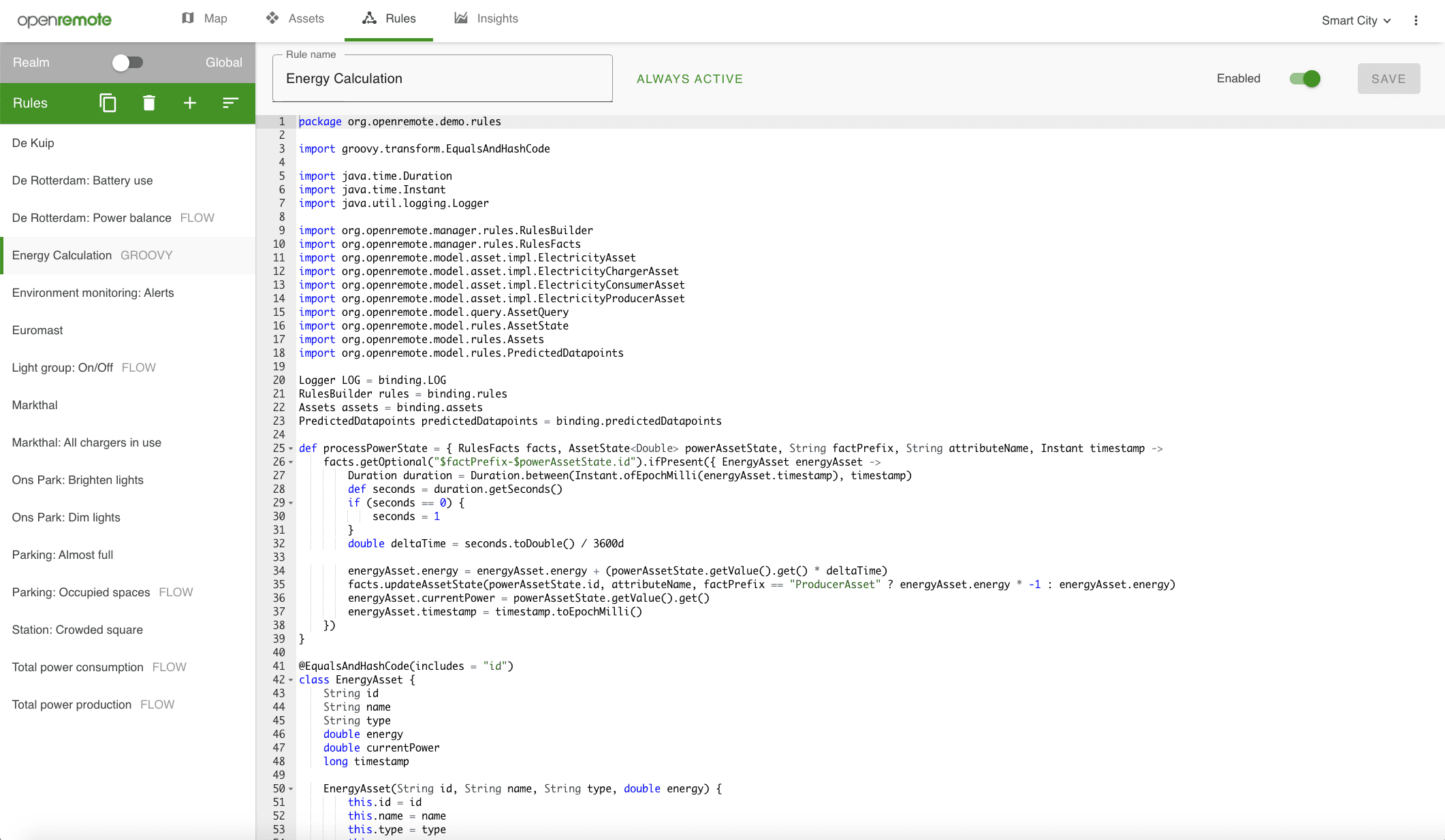

  • GROOVY: programming any advanced logic, using attributes in the system. All rules can be set to only be active during a (recurring) event set with the scheduler.

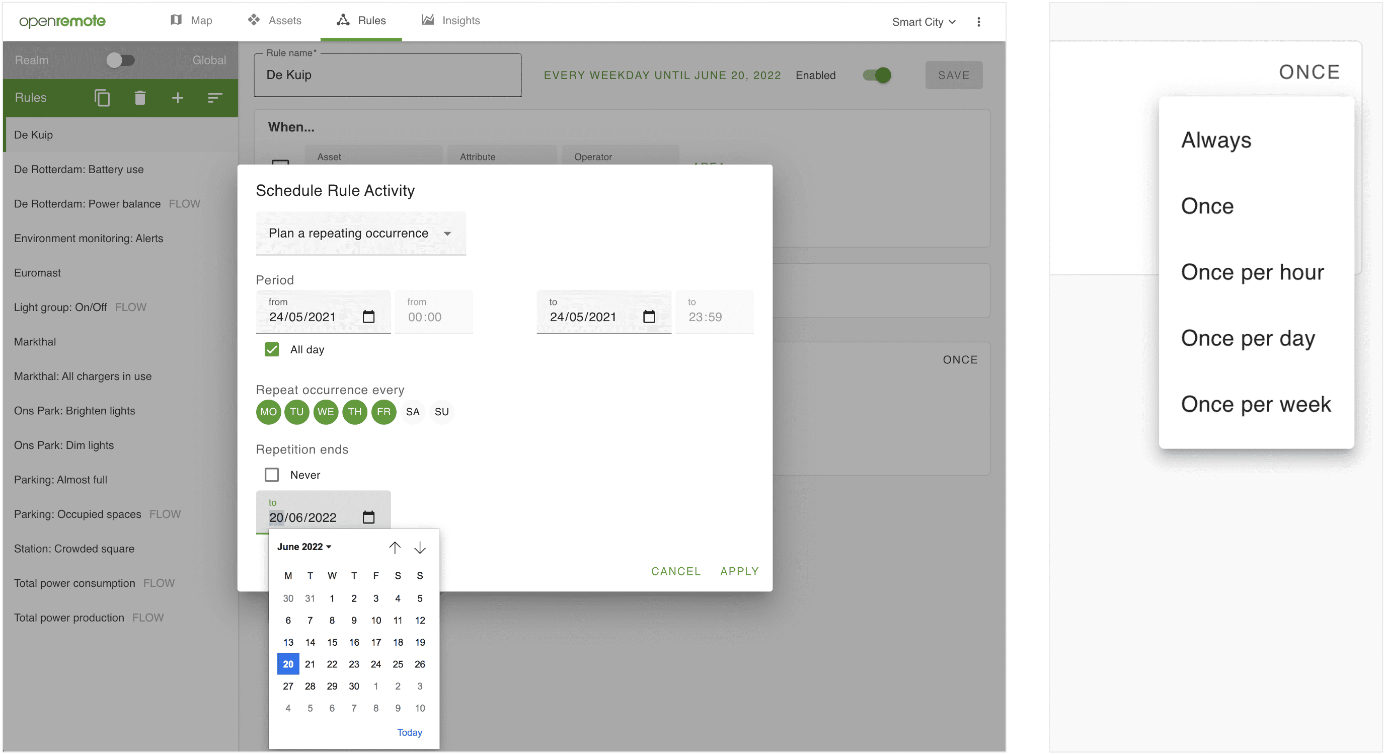

The frequency on which rules trigger as well as a timer schedule can be set. The rule frequency, a dropdown on the upper right of each 'Then' panel defines how frequently a rule can trigger. For example 'Always' means every time the condition is triggered, but only after the condition has been false (so not continuously on being true). The scheduler (right next to the name field of the rule) lets you set an occurrence period as well as repeat that occurrence.
Figure 8. The Rules trigger frequency (right) as well as time scheduler (left) defines when rules are triggered and active. The scheduled example sets the rule to be active until June 20 2022, only on weekdays.

Groovy rules are intended for more advanced processing and automation (see an example in figure 10). For more information see Groovy Rules.
Figure 10. Groovy rules for more advanced processing, logic or automation

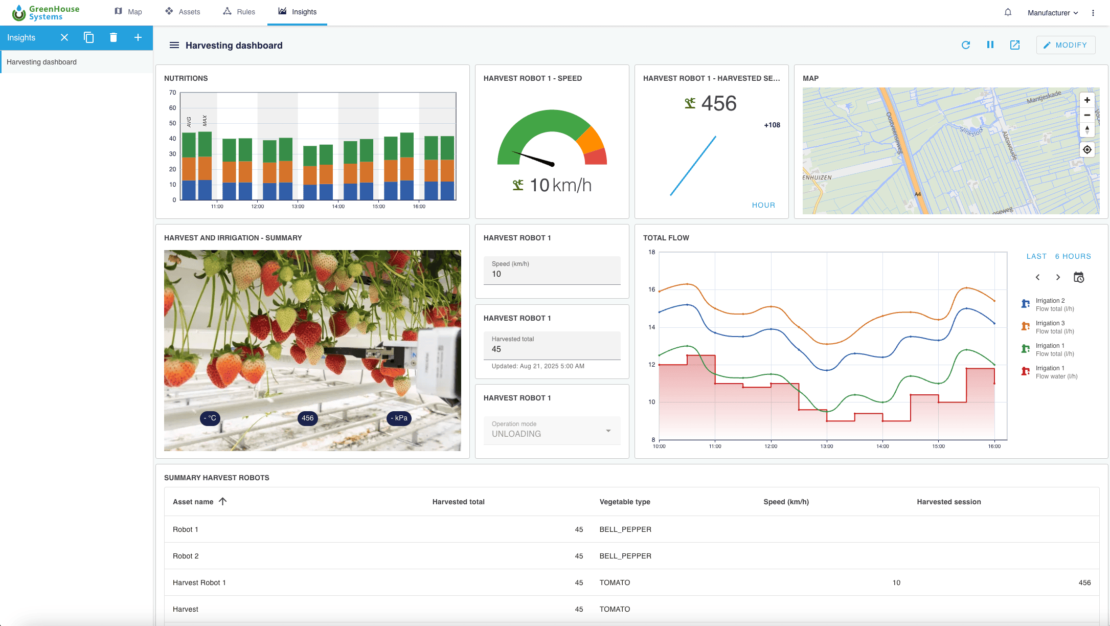

The Insights page (see figure 11) allows you to create multiple dashboards within the manager UI. You can:
  • Define the dashboard behaviour for different screen sizes and optimise the design for a specific screen.
  • Share dashboards with other users even as standalone app, or keep your dashboard private.
  • Make dashboards public. Note this requires assets to be set as 'public' and attributes as 'public read'.
  • Share via the iOS or Android console and benefit push notifications (see figure 12).
  • Use nine types of widgets (or extend with your own): Line Chart, Bar Chart, KPI, Gauge, Image, Map, Table, Attribute (with control) and Gateway.
  • The gateway widget allows for opening the Manager UI of OpenRemote instances connected as gateways to this instance. See Gateway tunnelling setup for the technical configuration.
Figure 11. Example of an Insights dashboard, showing a dashboard with eight different types of widgets.
Figure 12. The Insights view of the Manufacturer demo accessed via the consoles, showing how your dashboards easily turn into an app for your end users.
