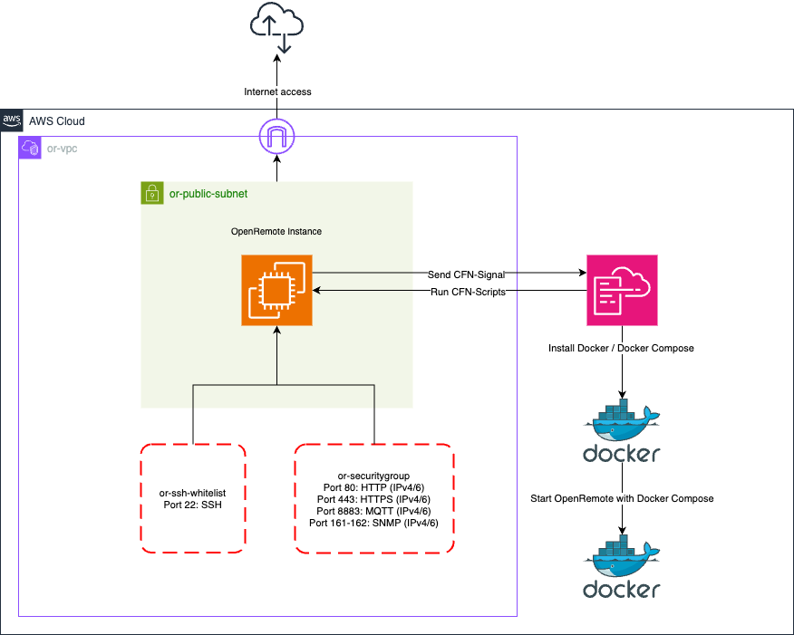

This product requires an internet connection to deploy properly. The following packages are downloaded on deployment:
DockerDocker Compose
Architecture Diagram
