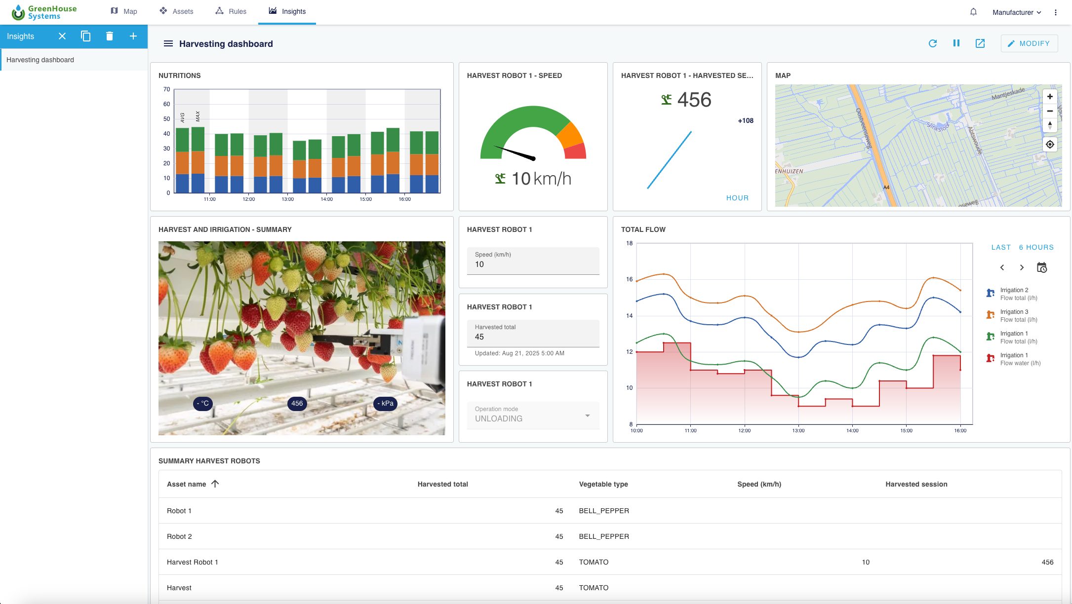

Insights
The Insights page (see figure 11) allows you to create multiple dashboards within the manager UI. You can:
- Define the dashboard behaviour for different screen sizes and optimise the design for a specific screen.
- Share dashboards with other users even as standalone app, or keep your dashboard private.
- Make dashboards public. Note this requires assets to be set as 'public' and attributes as 'public read'.
- Share via the iOS or Android console and benefit push notifications (see figure 12).
- Use nine types of widgets (or extend with your own): Line Chart, Bar Chart, KPI, Gauge, Image, Map, Table, Attribute (with control) and Gateway.
- The gateway widget allows for opening the Manager UI of OpenRemote instances connected as gateways to this instance. See Gateway tunnelling setup for the technical configuration.
Figure 11. Example of an Insights dashboard, showing a dashboard with seven types of widgets.
Figure 12. The Insights view of the Manufacturer demo accessed via the consoles, showing how your dashboards easily turn into an app for your end users.

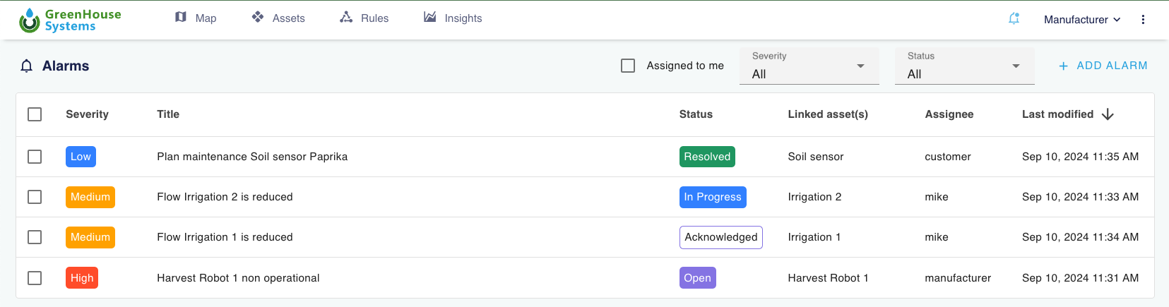

Alarms
The alarms functionality (top right) allows you to automatically generate alarms, assign them to users, and track their status. You can also see an overview of alarms assigned to you, and high priority alarms are automatically send to assigned persons. These features are supported:
- Generate alarms with rules: Alarms can be created by When-Then rules.
- Severity: High severity alarms are automatically emailed to the assigned person.
- Assigning alarms to users: Assignees always have an overview of alarms assigned to them.
- Status: The status indicates the steps in a typical workflow: Open - Acknowledged - In progress - Resolved - Closed.
- Linked assets: Assets which triggered an alarm rule will be displayed to make it easier to resolve problems.
- Ordering and filtering alarms.
Figure 13. The alarms page with an overview of all alarms.

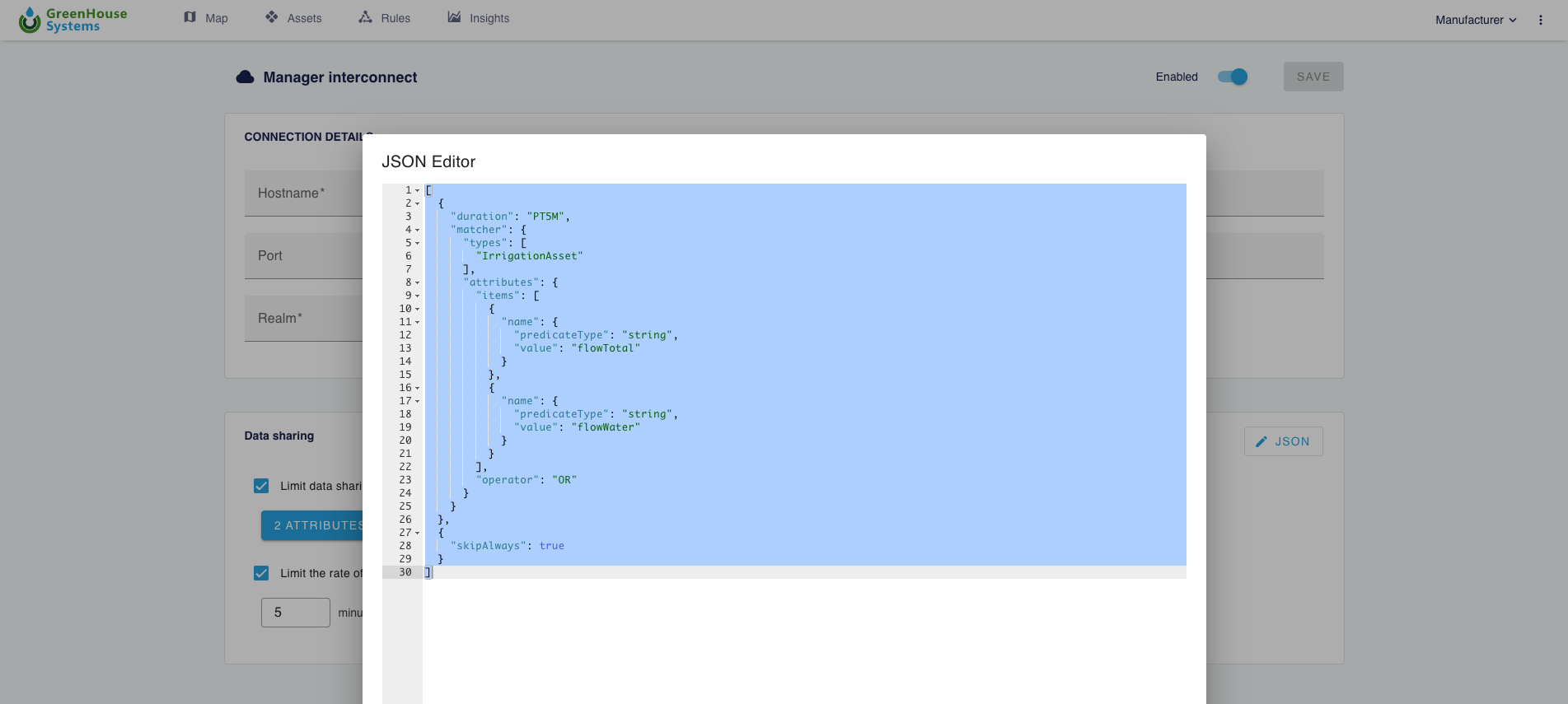

Manager interconnect
You can link multiple instances of OpenRemote (as Gateways) to a single Central instance of OpenRemote by creating a Gateway asset in the central instance and linking the Gateway instance of OpenRemote, using the 'Manager interconnect' function. The Gateway in the central instances will show the assets of the linked Gateway instance of OpenRemote, as children of the Gateway asset and will enable bidirectional communication with its attributes. Moreover, to limit traffic, you can select and limit the attributes shown as well as the rate at which they are synchronised with the Central instance. See the Edge Gateway documentation for more details.
Figure 14. Several OpenRemote instances can be interconnected, e.g. connecting multiple instances on edge gateways to one central cloud hosted instance. The Manager Interconnect page, used at the edge instances (left) uses the keys which are created on the central instance by adding Edge gateway Assets (right).
Figure 15. Next to interconnecting you can choose which asset attributes are actually linked as well as the rate at which data is exchanged.
