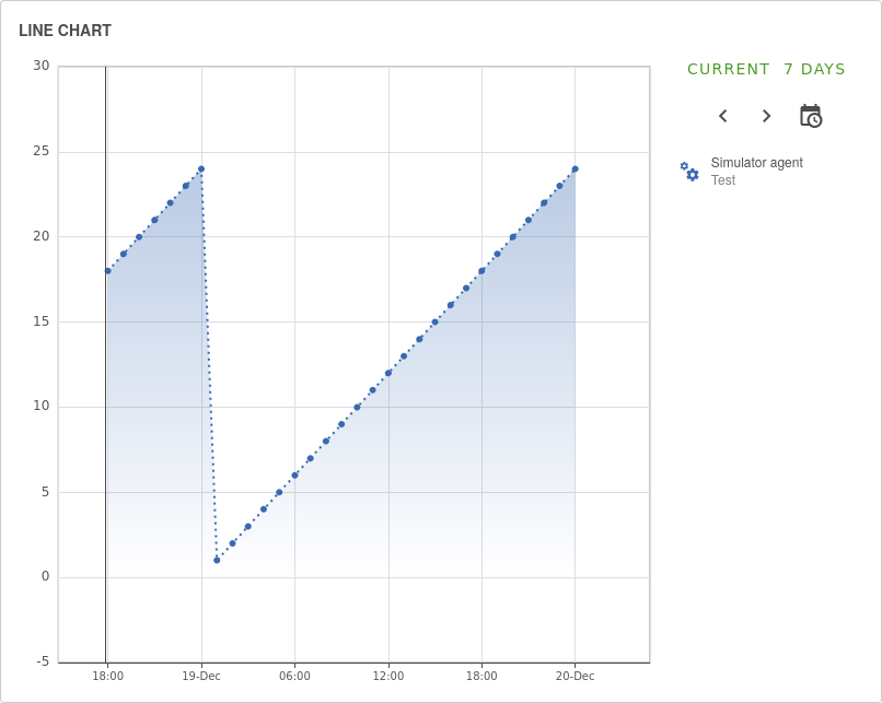

Simulator Replay Datapoints​
Attributes linked to this agent that have a replayData field in their Agent Link will cause the values within to be replayed over a 24h period in a continuous loop, unless a schedule is configured. Each SimulatorReplayDatapoint value must have a timestamp (seconds offset from midnight 00:00 in the system time of the machine that hosts the manager) and a value, this value will then be written to the attribute at the specified seconds offset from midnight each day.

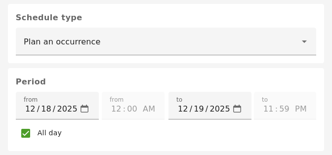

The schedule can be set to occur only once by selecting "Plan an occurrence". This will allow a period to be specified where the data will be replayed. Any datapoints specified to be replayed after the end date are ignored.

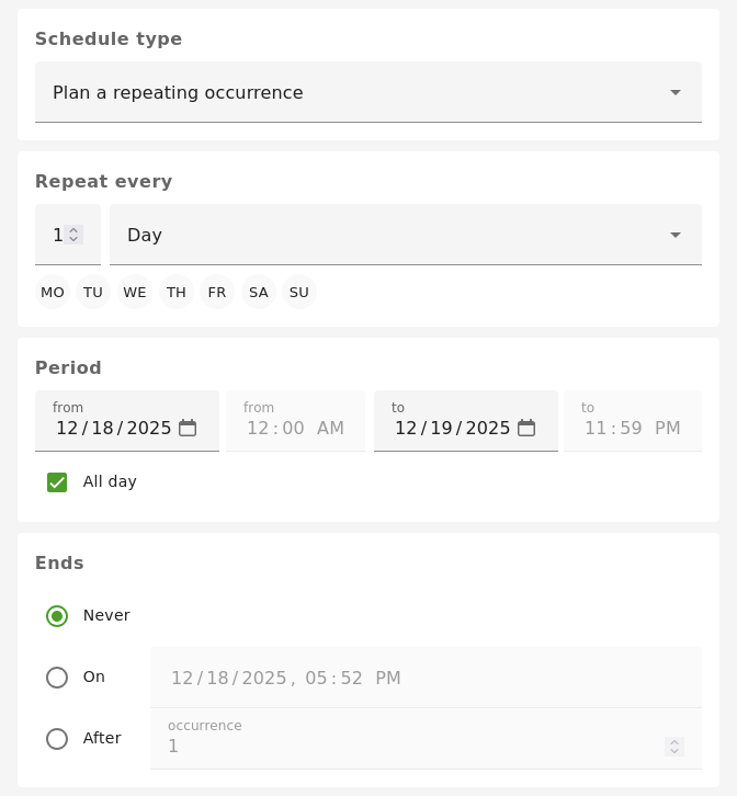

The dataset can also be replayed recurringly by selecting "Plan a repeating occurrence". In addition to the period options this allows a frequency to be specified and how the repeating occurrence ends.
The frequency defines how often the replay data is replayed. The frequency can be set to replay the dataset every minute, hour, day, week, month or year. By increasing the number alongside the selected frequency (the interval), the frequency will change to run every few minutes, hours, days, weeks, months or years. Besides the interval and frequency, the dataset can also be replayed on certain days of the week when selected.
The repeating occurrence ending can be specified to stop at a certain date and time or set to end after a certain amount of occurrences.
These options follow the RFC 5545 RRULE specification.
