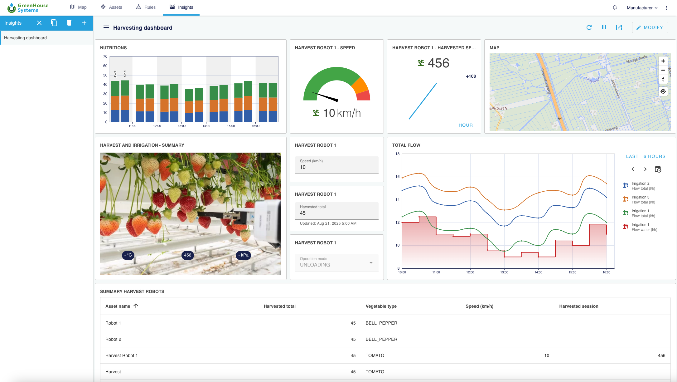

The Insights page (see figure 11) allows you to create multiple dashboards within the manager UI. You can:
  • Define the dashboard behaviour for different screen sizes and optimise the design for a specific screen.
  • Share dashboards with other users even as standalone app, or keep your dashboard private.
  • Make dashboards public. Note this requires assets to be set as 'public' and attributes as 'public read'.
  • Share via the iOS or Android console and benefit push notifications (see figure 12).
  • Use nine types of widgets (or extend with your own): Line Chart, Bar Chart, KPI, Gauge, Image, Map, Table, Attribute (with control) and Gateway.
  • The gateway widget allows for opening the Manager UI of OpenRemote instances connected as gateways to this instance. See Gateway tunnelling setup for the technical configuration.
Figure 11. Example of an Insights dashboard, showing a dashboard with eight different types of widgets.
Figure 12. The Insights view of the Manufacturer demo accessed via the consoles, showing how your dashboards easily turn into an app for your end users.
