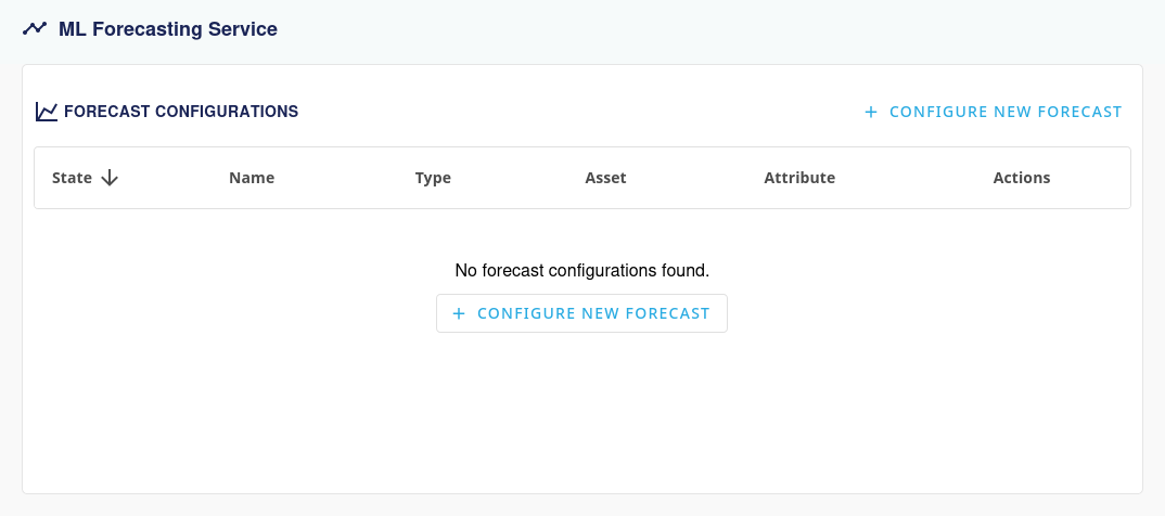

When the service is selected, you should see a list of forecast configurations. If none are present, you can create one by clicking the Configure New Forecast button.
ML Forecasting Service
You can then configure the forecast by filling in the form.

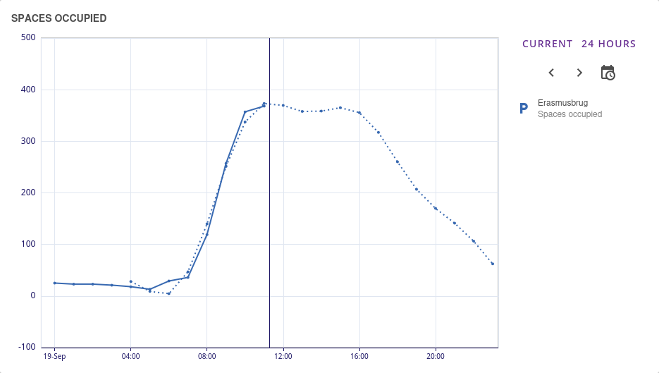

Once the forecast is generated, you can view it in the Insights UI.
The forecast will be displayed as a dotted line in the chart.
