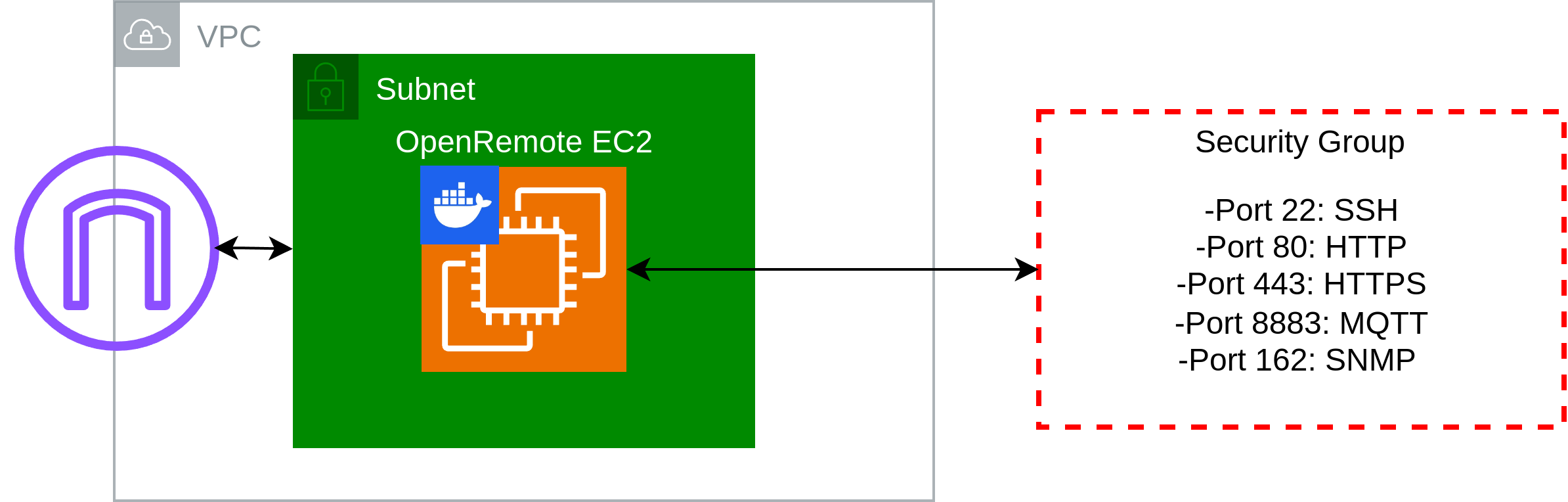

We have created an app for the AWS Marketplace to make deployment of OpenRemote easier. This guide describes how to configure the instance using the special AWS CloudFormation template.
Architecture Diagram
