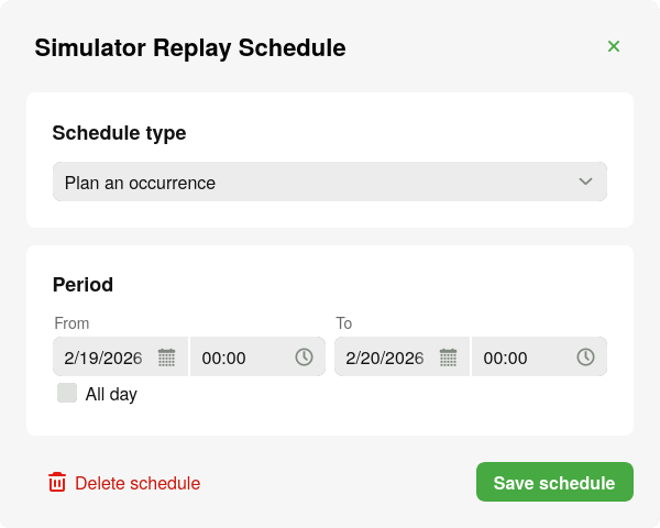

Schedule​
The schedule can be set to occur only once by selecting "Plan an occurrence". This will allow a period to be specified where the data will be replayed. Any datapoints specified to be replayed after the end date are ignored.

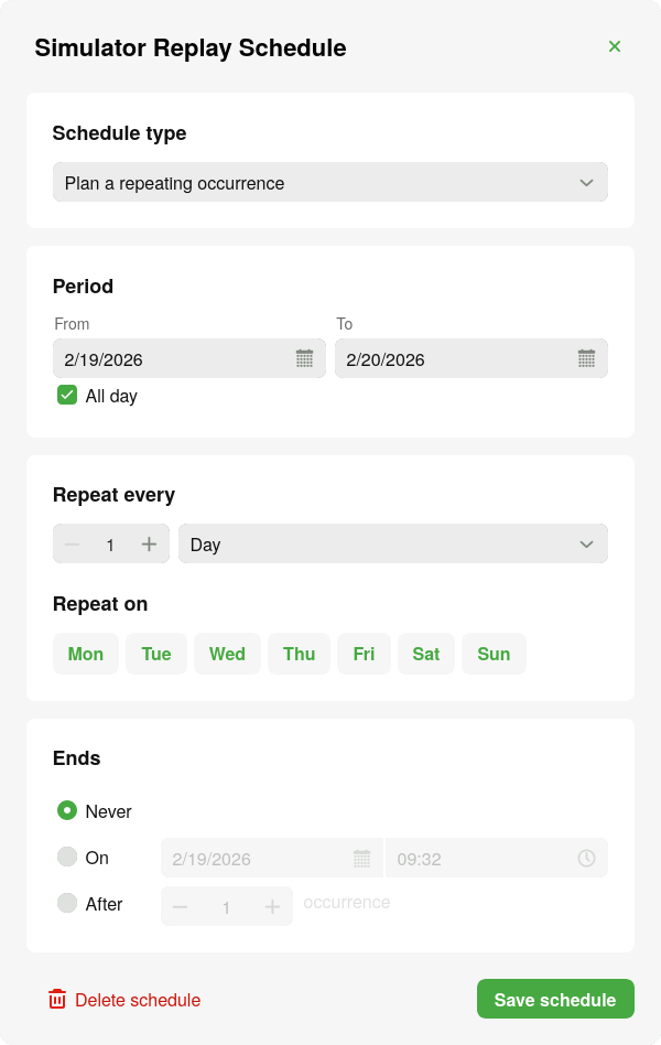

The dataset can also be replayed recurringly by selecting "Plan a repeating occurrence". In addition to the period options this allows a frequency to be specified and how the repeating occurrence ends.
The frequency defines how often the replay data is replayed. The frequency can be set to replay the dataset every minute, hour, day, week, month or year. By increasing the number alongside the selected frequency (the interval), the frequency will change to run every few minutes, hours, days, weeks, months or years. Besides the interval and frequency, the dataset can also be replayed on certain days of the week when selected.
The repeating occurrence ending can be specified to stop at a certain date and time or set to end after a certain amount of occurrences.
These options follow the RFC 5545 RRULE specification.
